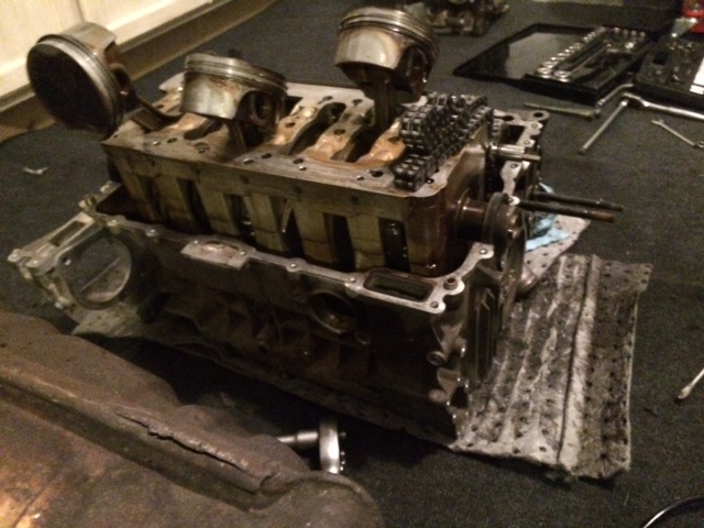

My two M96 engine issues
First one 996 C2 cylinder no.4 ate its self. PO never took care of it (oil changes) not the cars fault 142500 miles. [ATTACH][ATTACH]Name:  IMG_0753.JPG
Size:  121.2 KB[/ATTACH][/ATTACH] Engine was parted out and new factory rebuild put in.
Second one 98 Box with C2 3,4 motor (motor 67000 miles) Variocam chain pads failed. Ha no engine damage, replaced valve cover, two cams, and variocam solenoid with cam chain. She runs strong (scary car). Never had IMS or RMS issues my third Porsche with M96 motor. Name:  IMG_1068.JPG
