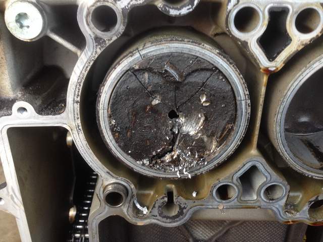

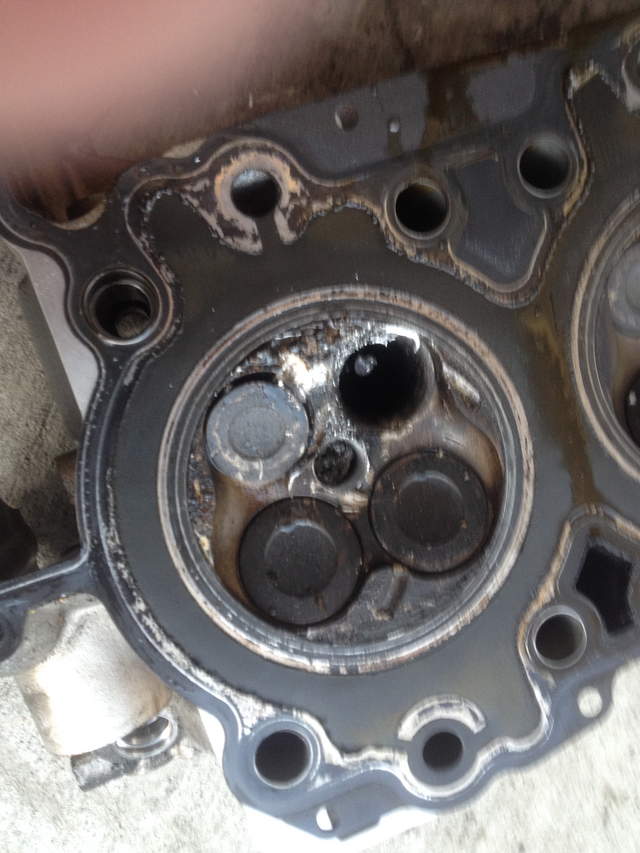

Hello, in response to your comments above: I recently purchased a 2002 Boxster from a Rover dealer in NJ. looks & ran great, 38k, two owner car. car was traded in & received major service for oil seal leak, new clutch, etc from sister Porsche dealer. have copy of $4200 service invoice. important point in decision to buy this car.
6 weeks later, catastrophic engine failure. IMS failure! I have driven many cars totaling almost 2 million miles & have never experienced an engine failure.
fortunately, the dealer included a used car warranty at the time of purchase, so the repair/engine replacement was covered. (fyi - re-manufactured engine was supplied by Vertex in Miami, FL. includes one year warranty from time of purchase, 11 months to me by the time I got the car back).
one week after I got the car back, I needed to return to have the headlight switch repaired/replaced, also covered. so far I have spent $350 on repairs for one remote replacement (key).
both a major failure and incredible luck that it happened under warranty, from a terrific dealer; Princeton Rover. they treated me VERY well. cannot imagine facing the cost of an engine replacement.
I will keep the car for now, but it will probably be both my first & last Porsche.
