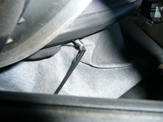

Does anyone know the Part# for this cable? Mines broke and when I ordered from the dealer, they gave me something totally wrong.

Nope, that's actually the one they ordered and it's totally wrong. It should be have to cuplers on each end to connect to the ball joints.
Argh, not seeing it on the Pelican site, which is actually a very cool site, thanks! I've bookmarked it
Here's a pick of the one I'm looking for, mines is on it's last leg:
