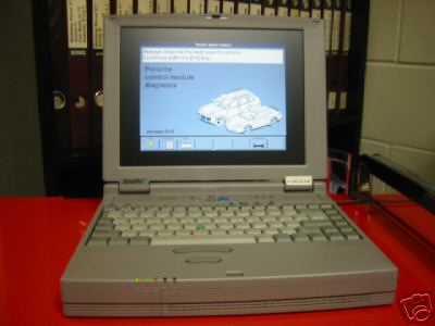

You are both going to have fun finding a real PST II, and you will be spending some cash as you will only find the system on dedicated laptops (usually Toshibas) because the system runs on a bastardized version of Windows 3.1:
As for the PIWIS, Porsche does not sell them, only leases them. First year lease in in the $20K range.

Try looking on ebay for completed listings, then contact the seller - there is a guy in europe that comes up with these from time to time, then lists them on ebay.
Otherwise your real challenge is finding the bosch PCM card that translates "porsche" to "computer," as the software/computer and cable are fairly available.

PST2 last update was version 24, long ago. Neither PIWIS1 nor PST2 will be updateable - the former because it would be an illegal system that will be frozen on any attempt to update, the latter because Porsche stopped updating it and orphaned the legal systems in the hopes of coercing more business to their dealers (or more revenue via leasing PIWIS).
But if you are dealing strictly with 986s, updating is not an issue. If you want to work on cars after 2005, you will need PIWIS instead of a PST2 and you may want update capability. If so, consider Durametric Pro instead ( realizing you will still be limited from coding keys and flashing DMEs with Durametric, but not much else.)
BTW you may still need programming codes from a dealer with online access to Porsche headquarters, to perform these operations, even with a functional PST2 / PIWIS.
I think the referenced kit on ebay is prob your best bet for now, though I have no experience with this particular setup. It looks like his offer includes the whole enchilada, would just need a monitor to view it. PIWIS seems to have a better user interface than PST2, I presume it has all the capabilities of PST2 and then some. It is almost certainly a pirated setup, and the seller lists his location as Germany but the item ships from Slovakia, so take that for what it is worth.
