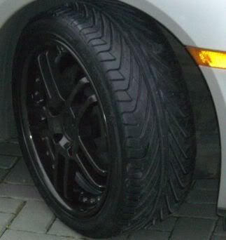

Well, the weather report for the next week is over 40F for lows, so I fit the new wheels on...

Bob,
I think they look great! I've always loved that wheel and IMO the dark version looks terrific on your silver car. I really like the contrast.
BTW, I don't think I've ever seen another 987 with a hardtop. Really looks good!
I have a set of Michelin Pilot Sports on another set of wheels. My recollection is the tread pattern went the other way. Are yours mounted properly or am I'm just confused?

Very nice! Is that a metallic black you used? Now you just need to de-amber those side markers.

Originally Posted by ddb
Bob,
ddb
Hey, you had me wondering as well, and after a comparison..., they are mounted incorrectly. :troll: :troll: :troll: :ah: :ah:
Believe me, it's exactly what I thought when i looked at it in the driveway..."deamber...OK, I've held out long enough!"

Originally Posted by fatmike
Nice!
Can you tell us more about your technique?
How did you sand (by hand, machine, etc.). What paper/grit combos? Did you have to repair any roadrash? If so, how?
What primer/paint did you use? Where did you get it? How did you apply it?
Sure, but you may be surprised!
First and foremost? I super cleaned everything with an orange based cleaner 3 times to get rid of all the brake dust and road grime. Then I used Acetone to final clean before I ever started sanding anything.
I used an 80 grit sandpaper wheel on a portable drill to get rid of the curb rash. I hand sanded everything down to 1000 wet starting at 400/600/800/1000 depending on how bad it was and when I was doing it.
For paint I use Rustoleum...Yup From Sandable primer, Metallic Black to Clear Enamel! All from Lowes for probably $6/can. I do use a spray attachment that plugs onto the top which helps spray technique. But also important, I warm every can of paint up in warm water and double shake prior to each time I shoot. I use many thin coats. I bet there are 10+ coats on these guys!
Hope that helps.
