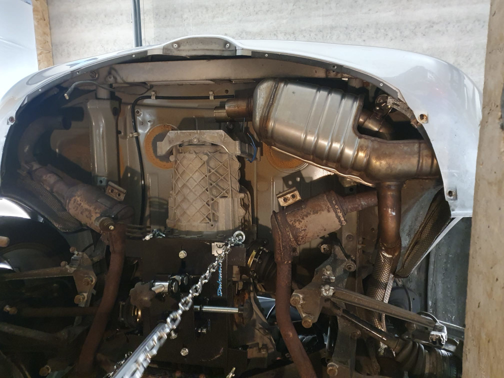

For the interested people; I have found a damaged 981 PSE muffler to trial fit. After removing the heat shield I would say it fits in quite nicely. So this is the route I will take for when the V8 goes in.
For the coming year I will trial fit a Dansk Sausage. Not too sure how much smaller that is, but hopefully it will fit behind this gearbox.
