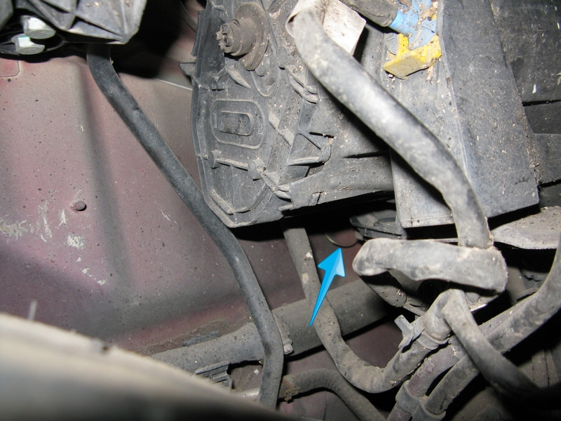

Old 12-12-2017, 09:40 PM   #6
From the front with headlight removed...
Old 12-12-2017, 09:42 PM   #7
And from the wheel well with headlight in...
Turn the wheel all the way to the left or get it off using an oversized socket hammered onto the security lug. It would help if you had an endoscope or at least a mirror.
I have a 2001 and this is where I found mine. Had to turn the wheel and remove the plastic liner to reach in. Just give it a yank if you find it.

Posts: 2,497
Looking got frunk cable:
You may have a tough time getting to it if it hasn't been relocated and you can't pull the inner wheel liner loose. Turn your wheels, and see if you can get the liner loose enough to see behind passenger side headlamp assembly.
BTW, If you need to get a wheel off without the lug bolt lock, find a close fit deep well socket and pound it on wheel lock. Hit it with an impact driver and it will come right off.
dghii is online now   Reply With Quote

This only works on base models and not the S because the third radiator is in the way. There are holes on the bottom of the bumper cover. If you reach up toward the right side of the car you can grab the cable and yank.
Woody
Will try that out, this one is a base. Thanks.
