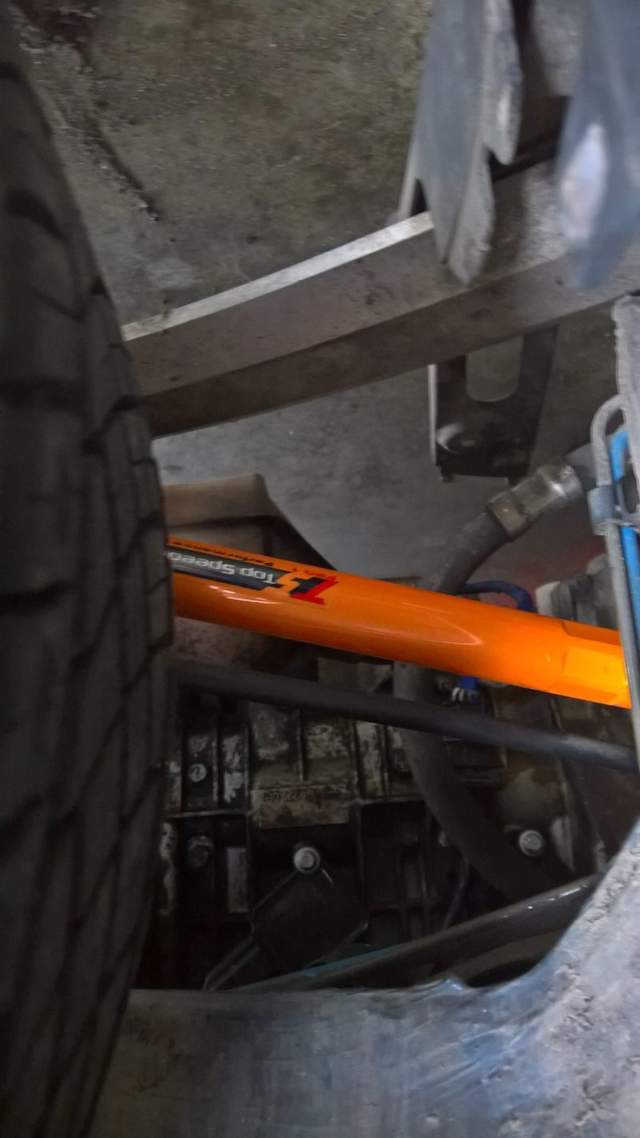

I recently purchased the Top Speed Rear Track Arms . I got them off ebay for about $170. The pair was about $10 more than a single rear track arm anywhere else. Once the old arms were broken loose, the install was very easy. We took the old arm off, adjusted them to the correct size, and re-installed.
All in all, it was a simple and straight forward swap. Took the car for a test drive afterward and so far it appears to be a good product. Previously, the car rattled a bit, front and rear, over potholes, not I'm hearing suspension squeaks from the rear and some rattles from the front.
Here are some pictures of the track arms post-install. I must say, I'm glad the price was right, because the orange of the track arms goes with the orange highlights on my car.

Quick update after driving around for a few days. It's been a mix of city and highway driving with the top up and down, brand new roads and some bad potholes.
Before the replacement there was a lot of rattling over any imperfections in the pavement and it sounded like golf balls in the trunk when I stopped.
After installing the new arms there are no golf balls in the trunk and no rattles over bumps. Makes the car a lot more appealing to drive now.

Do keep an eye on the welds on them. I sold a pair after being on my car for 3 years and the new owner said one of them had an end piece that broke off when he was installing it. Fortunately, he has a welding machine and welded both of them up and they're better than new now, although not as pretty.
The other thing you must remember about Top Speed control arms is they are quite heavy in comparison to their factory counterparts due to the fact they're not made of aluminum but steel.
