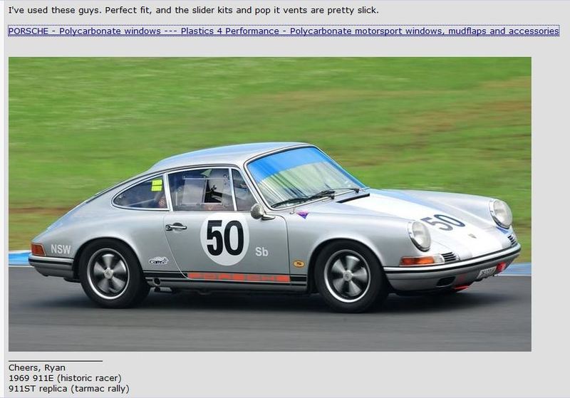

How about that with a clear vinyl (like the rear window) held in place with snaps or velcro?
Fixed Lexan with a slider? Polycarbonate-Lexan Window Source??? - Pelican Parts Technical BBS
