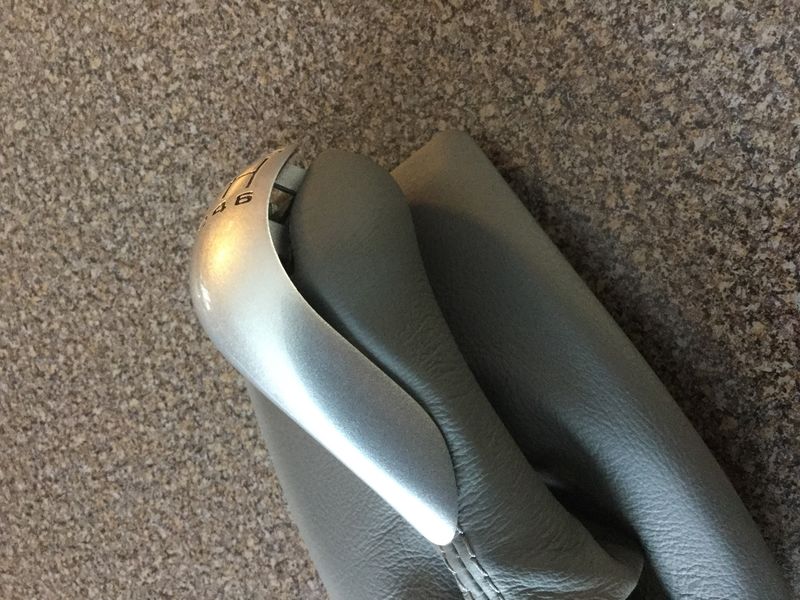

A 986 S 09-04-2016 06:58 AM
shift knob paint?
Some of the silver paint has worn off the hard plastic bit of my Boxster's shift knob. The obvious fix would seem to be to remove the worn plastic piece and either repaint it silver or remove the remaining paint and just leave it shiny black. Examining the knob & boot assembly doesn't reveal an easy way to take it apart. Am I missing something or can it not be dissembled? Do I have any other options?

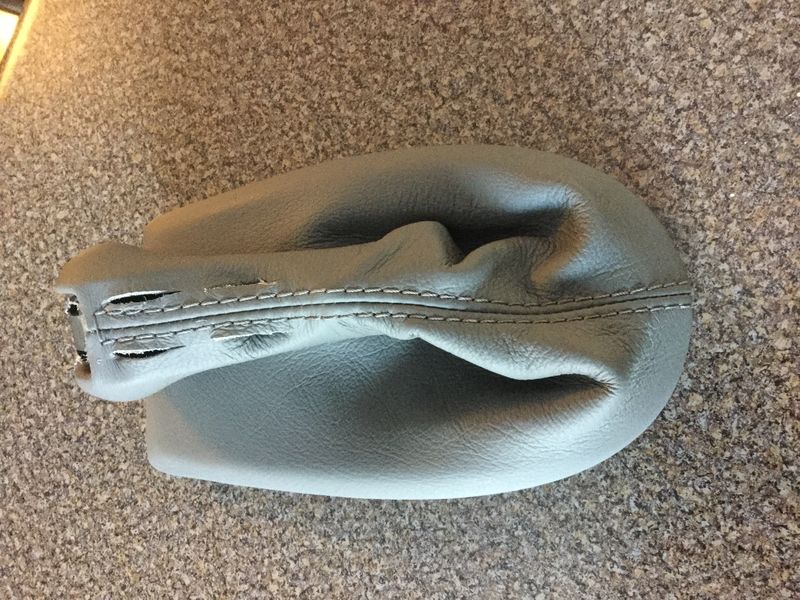

jakeru 09-04-2016 10:15 AM
I went though this process of restoring my similar 2001 boxster shift knob, and that silver-painted plastic trim piece is simply pressed in to the hard rubber knob frame. The leather is wrapped around the frame and tucks in underneath the trim piece. The shift pattern insert is glued (with a thick, flexible and removable-grade adhesive) onto the trim piece.
The silver-painted plastic trim piece just pries off/away from the rubber frame. I'd recommend starting at the bottom area on one of the sides, and once you have a start, work the gap gently around the rest of perimeter, a little bit at a time.
Be very careful if using metal tool not to dig into the plastic edge, or the leather. Using wood or plastic will be safer. I think I used a butter knife very carefully, to get it started also. One I had it started, I recall stuffing in a bunch of toothpicks into the gap, whereever I could.
When you get the trim piece removed, it will be much more flexible, which makes it easier to pop off the shift pattern insert piece.
I'll see if I can find pictures of the process. I do have a readily available picture of the completed job (I also refinished the leather).
I refinished my trim piece using a silver paint as basecoat, and then clearcoated it with a 2-part clear. Turned out nice and should be very durable (probably more so than original!) The shift pattern insert is a transparent acrylic-like material (with painted black and white background and insert pattern at the back, so to restore that, I mostly just polished the front face, and added some extra black paint back there to touch up the black background.

I found the pics... Hope they help!
1. "before" picture
2. pieces disassembled
3. closest silver color matching paint found
4. leather dyes used
5. trim piece, base-coated
6. trim piece, clear-coated
