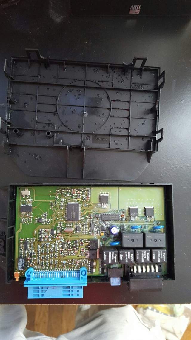

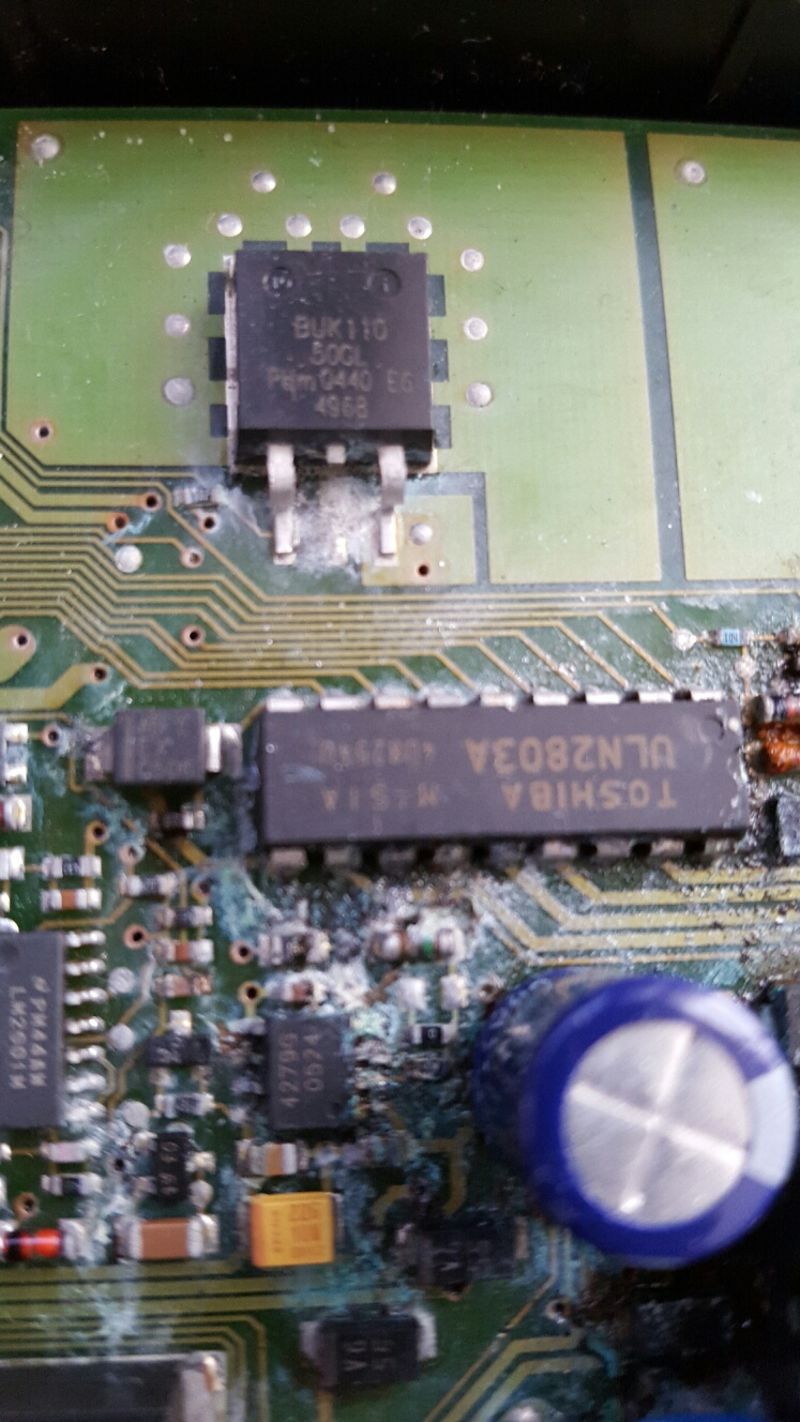

I have a 01 Boxster that won't start. I am almost 100% sure that it's the immobiliser but I'm not sure of the next steps.
The alarm went off, I unplugged the battery to stop it, reconnected it and everything works BUT it won't start. The carpet is soaked so I removed the seat to find a good amount of water underneath. I removed the immobiliser to have dried the box and circuit board. I do see some corrosion and there was some condensation and water inside. I'm not sure if it will still work or not. I plan to let it completely dry and then reinstall to test (btw do I have to reconnect the seat wiring of just the immobiliser unit to test?).
Has anyone had this issue and successfully repaired it? Do I need to go online and buy another circuit board if this doesn't work??? and if I do should I get another key, transponder, ignition, etc to go with it??? Does it have to be reprogrammed by a dealer???
Any advice would be greatly appreciated.

So the long process is over. The issues was the Immobilizer. I was saved when I read this post from Pedro and i suggest anyone who runs into an issue with their's, try this first before replacing:
"Try removing the driver's seat and then the CLU.
Disconnect it from its harness, remove it from the car and open the case.
Remove the printed circuit board and dunk it in a shallow recipient and cover it with isopropyl alcohol.
Shake it well so the alcohol penetrates all the spaces, in particular between the chips and connections.
Then, let it dry. You can accelerate the drying by using a hair dryer in the cool mode.
Dry out the inside of the case if it had humidity and put everything back together.
If it was water causing the problem, it should now work fine.
We have saved many CLUs this way."
Thanks everyone for your help!

Good news....I dried the circuit board and enclosure, gently cleaned the board with a toothbrush, reconnected everything....and just like magic, she started right up!!! Problem solved. I do plan on finding the source of the leak and getting the waterproof case. I am relieved that I didn't have to drop another stack of cash to figure this out. The ONLY problem so far is that my airbag light is on and my interior dome light stopped working...smh. Go figure. I'll work on that part tomorrow
