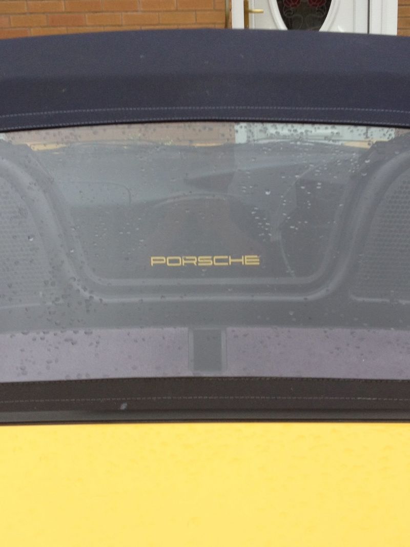

Hi Chaps
Thought Id finish off the deflector with "PORSCHE" lettering in yellow to match the body
looks ace cost pennies
