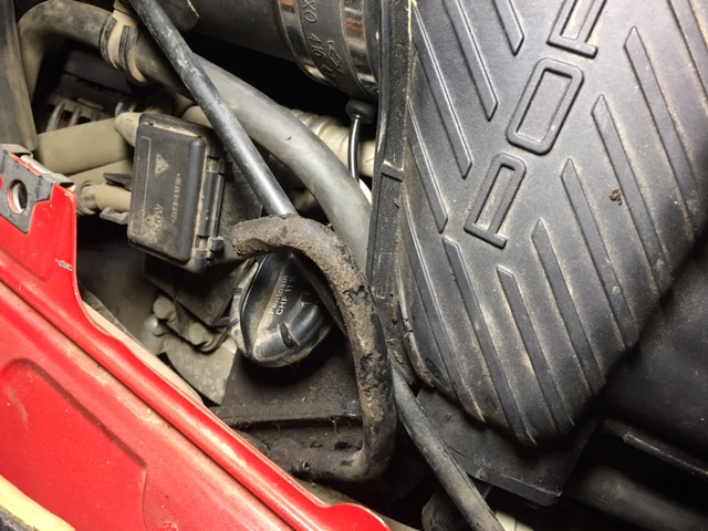

Brake boost vacuum line? That's the biggest one and I'd think most likely to completely stall the engine. It mounts to the front left or right rear intake manifold and the opposing one should be covered/blocked.
I took a look this morning and found this, should it attach to something?

That looks like the power steering overflow hose. It doesn't attach to anything.
