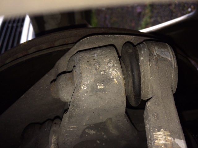

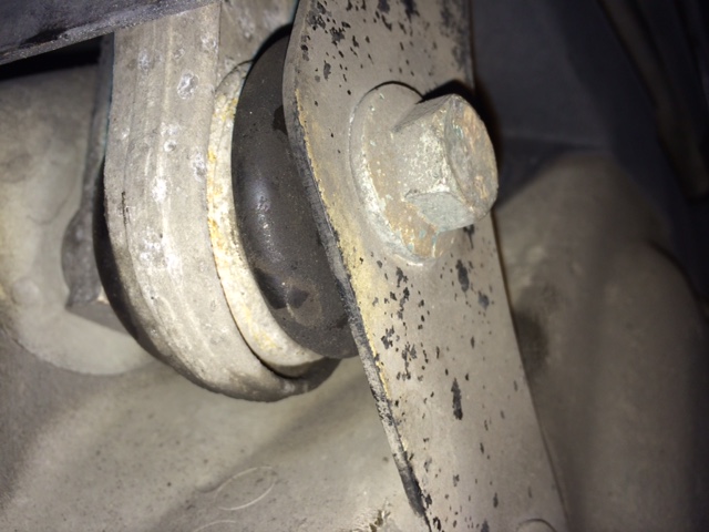

Ive jacked up the car and given it a good shake down and found that when i turn the steering wheel, both wheels move the same amount and when i move the wheels the steering turns the same amount. no clunks. so i dont believe its a tie rod or steering issue. also the car turns fine on the road. it just gets squirlley when i hit a bump.
I've been trying to inspect the wishbone and control arm and drop links but don't find any cracks or tears in the boots/bushings. and i cannot find any play with the suspension loaded or unloaded. but maybe im not doing right?
I've inspected the upper strut mounts and they seem to be good and bushing is still there, maybe half inch of solid bushing.
I also shook the wheel at 12 and 6 and found no play so im assuming the wheel bearing is fine. there is also no road noise when just driving along. only when i hit a bump and only when i hit a bump a certain way.
Also; when i jump up and down in the trunk or push on the fender side to side or up and down i cant get any noise at all because of this im leaning more towards the tuning fork/control arm. track arm or whatever it is called forward most control arm.
any help would be really appreciated! Im leaning towards the ball joint on the wishbone or the ball joint on the control arm but not sure which would cause this issue.

jakeru thank you very much for your reply. Yes its this front trailing arm that ive been suspecting as the culprit so i will probably end up replacing this first or maybe trying the repair that you posted (thank you again)
I will try dragging the brakes in the morning but i can tell you that the noise does happen if under acceleration over bumps and turning while accelerating also seems to still make the noise but i will try braking in the morning.
Called the local porsche dealer here and the trailing arm cost is $358 for 1 pretty pricey. so i might try the fix and see if i can hold out for an online one to ship in.
Thanks for the link to the video, Ive actually seen it earlier today in my searches and watched it a few times lol.
One thing im concerned about is if it could be the trailing arm bushing that sits in the wishbone and not the ball joint on the trailing arm. or are these not so prone to wear/noise?
Like I said, the bushings in the control arm look good with no splits and the boots on the ball joints have no tears but they are hard to inspect. still cant find any looseness

Edit: Ok so today it is very wet and rainy here in Vancouver Canada and i took the car down to the local auto parts to buy oil etc (needs a change) I drove the whole way with radio off and listening to the noise except the noise happened for the first couple blocks but then got quieter and quieter.
I was also trying dragging the brakes over bumps that would make the noise and no sound. by the time i got home i pulled in and out of my driveway a few times trying to make the noise but it wouldn't.
So im wondering if water is getting into something to stop it from making such a bad noise acting as a sort of lubricant?
@Racerboy - the feeling of the wobble does feel like a loose inner tie rod but ive inspected the tie rod ends and there is no play so perhaps it is the lower ball joint on the wishbone as you describe?
If it was the lower ball joint would I be able to replicate the sound by getting me and another to push up and down on the fender? because Ive tried that also and nothing.
Leads me to believe the noise may be of longitudinal movement rather than lateral movement.
@stevedox - Not sure if ill try the 997 trailing arms but i thank you for the input and part numbers!
Any thoughts on why the noise wouldn't happen in the rain?

this is a photo of the lower ball joint on the wishbone that connects to the carrier..
this is a photo of the outer tie rod end...

here is another photo of the lower ball joint on the wishbone
