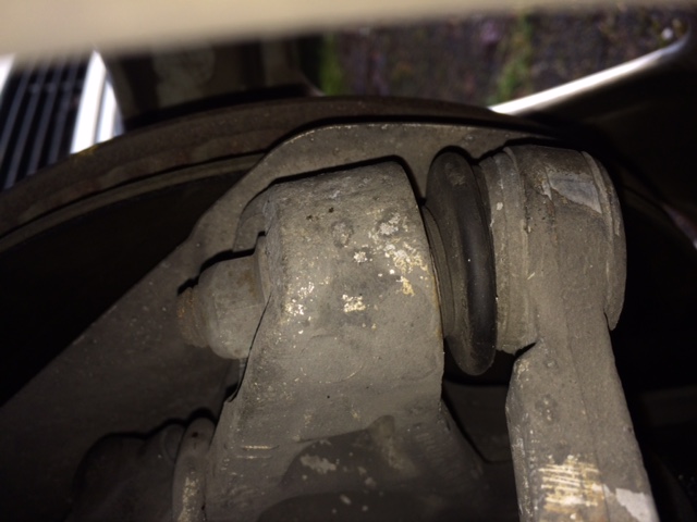

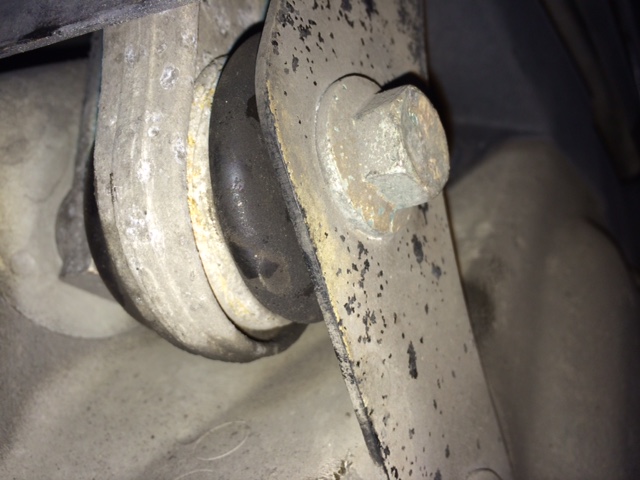

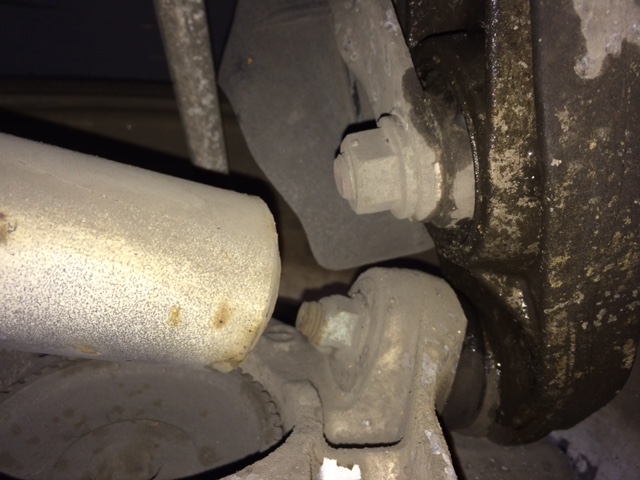

Okay so I took the car out for a drive for an hour and no noise but some pulling on the highway the whole way there. on the way back however i had noise and still a little pulling/feedback. I took a video on my way back and you can hear the noise that im talking about and the steering wheel shake im talking about/ pulling. Im just uploading it to youtube now and will post the link when its done (about 1 hour)
In the mean time i took some pictures of some of the suspension components in the offending front driver side wheel area for you guys to see. and i also took some of the rear end for you to see. and i believe its worth nothing that both sides front and back look identical. the first 2 pictures are of the rear suspension... Attachment 20136
Attachment 20137
this is a picture of the bottom of the wishbone on the front drivers side. the trailing arm bushing...

This is a picture of the strut on the same side... the bump stop is almost completely gone. however this is intact on the passenger side and rears.
Attachment 20139
and this is a picture of the trailing arm on the front drivers side at the ball joint connection.
Attachment 20140

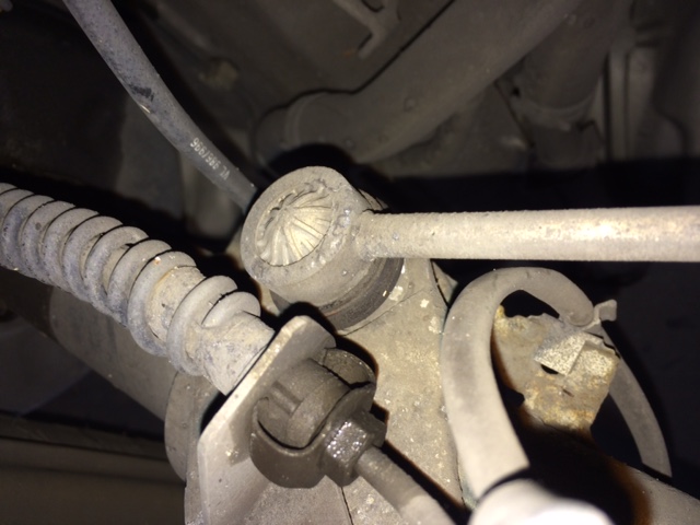

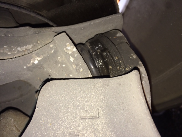

Gordons986 03-11-2016 02:53 PM
4 Attachment(s)
more pictures of the front suspension...
this is a photo of the lower ball joint on the wishbone that connects to the carrier..
Attachment 20141
this is a photo of the outer tie rod end...
Attachment 20142
this is a photo of the stabilizer/end links
Attachment 20143
here is another photo of the lower ball joint on the wishbone
Attachment 20144
