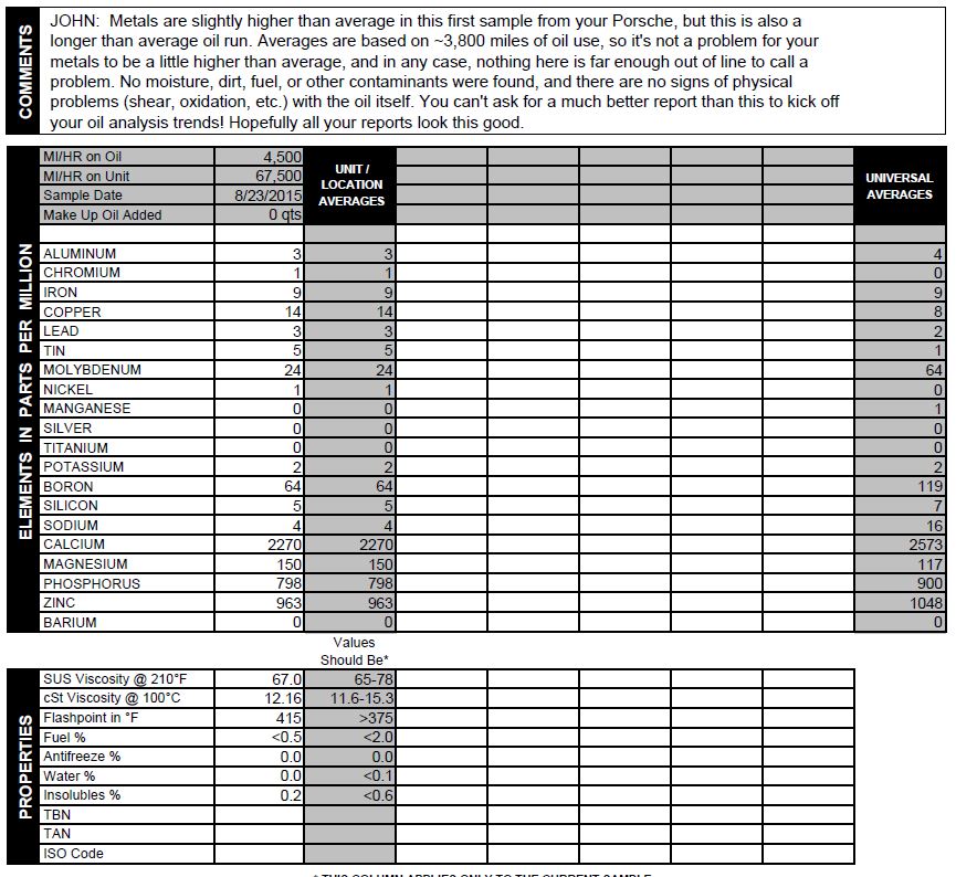

Old 09-11-2015, 01:36 PM   #12
jpc763's Avatar
Join Date: Aug 2014
Posts: 345
Here is the Blackstone report
