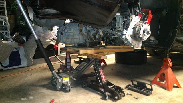

Beginner
Jamesp's Avatar
Location: Houston
Posts: 1,659
Here is a pic of the parking brake.
The tiny shoes behind the wheel flange.
2003 S manual
