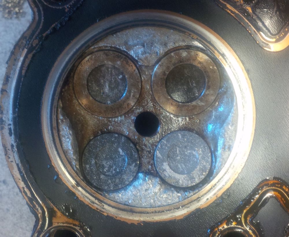

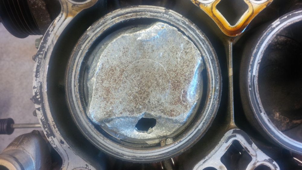

Well finally got around to dropping the engine and here is what I found........not happy at all

Is that an example of the infamous D chunk?

Posts: 1,659
What did the head look like? Did you drop a valve?

Posts: 6,707
No, piston failure.
Old 05-03-2015, 09:28 AM   #18
Posts: 7,675
Ouch! But I think that is what we were all expecting based on the condition of the spark plug.
Have a shop swap in a cheap replacement engine and you can be back on the road for less than $4500. Even less if you can do the swap yourself.
Not as bad as I thought it would look.
All valves seem Ok
