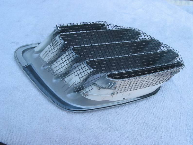

You can install a mesh screen to keep out larger debris like leaves and cigarette butts. The water issue however you cannot protect from. Our latest car wash, if you do such things to your Boxster, blows water in to the sides of the car under pressure so you wouldn't want to do that. I am going to include a pic of the screen I put in my vents to prevent debris.
