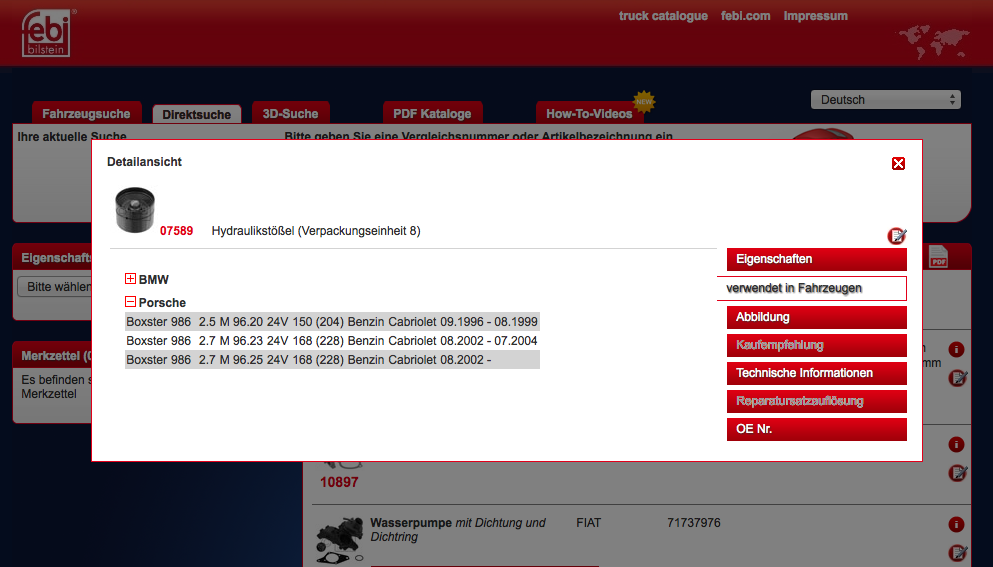

Old 02-25-2015, 11:08 AM   #13
Join Date: Dec 2009
Location: Orange County, CA
Posts: 2,023
The lifters have an updated INA part number. Most of the old ones get the tappet 'hammered' or jammed into the bucket. No repair possible. This causes the "they all make that ticking noise" comments about the older M96 engines?
Replacing all 24 @ $40+ each is a bit steep. $8 was much better!
Gelbster,
May I ask you where did you buy the INA lifters for $8..?
Thank you!
Old 02-25-2015, 11:44 AM   #14
Join Date: May 2014
Location: S.California
Posts: 2,029
from Rock Auto

are the M96 and 987 lifters different?
This is more like the M96 lifter. .
I would like to know if the M96 and the 987 lifters are indeed different or we are just talking a marketing gimmick perhaps…?
If by any chance these are interchangeable with each other there will be a Big price difference…!
Old 02-25-2015, 06:42 PM   #19
Join Date: May 2014
Posts: 2,029
987?
for the M96, just look it up the Rock Auto catalog BGA....
Check with INA
Check the Interchange catalogs.
They fit but I do not know if they work -yet.
Whatever ,they will work much better than the ones I removed!
