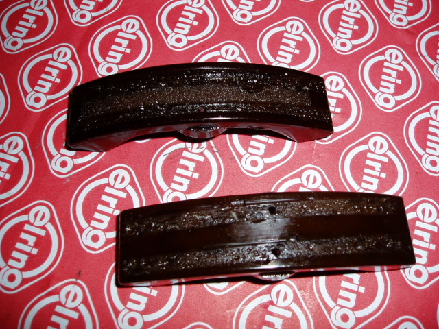

Here are my pads at 96k, look well passed there sell by date
whitecliffs is offline   Reply With Quote
