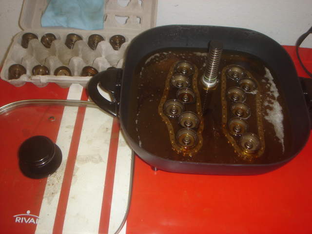

Jeeez what do you have there? Timing chain frickazee........hmmmm yum!
