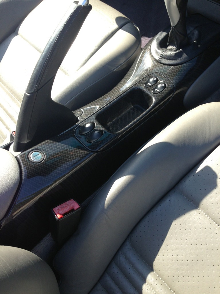

Not hard at all, 101 projects book helped a lot with screw locations. Had mine hydro dipped in carbon lookName:  ImageUploadedByTapatalk1377226294.277198.jpg

@juicepro - your faux CF console looks great! Seems your e-brake could use a good adjustment (w/ the pulley arm under oddments tray). Should only need to be raised a few clicks.

Originally Posted by juicepro View Post
Not hard at all, 101 projects book helped a lot with screw locations. Had mine hydro dipped in carbon lookAttachment 17728
Where in Cali are you? Where did you get your console dipped, and what did it run you?
