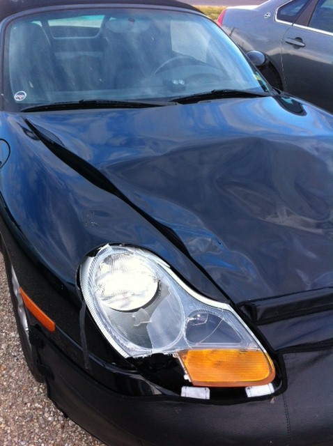

I'm not sure what happened to the deer but the Boxster got the worse end of it. Since the Porsche dealer does not have a body shop, is there anything special I should ask the local panel beater to look for other than the usual radiators, fuel tank, lines and hoses? It is going to be down at least a month.

I don't think you have to worry about the fuel tank it is pretty well protected as are the lines, looks like you got away lucky, I have seen a lot worse.

From the look of things, I'd bet Bambi wasn't long for the world.
This may be obvious. If the condensers or A/C lines were breached, ask the A/C shop to evacuate the system prior to filling it with refrigerant to get as much moisture out as possible. You might consider replacing the A/C drier too as extra insurance.

i'd bet you didn't even touch the radiators or condensers. and you got lucky it didn't hit the windshield or top. looks like just sheet metal.

First I'd insist on the car getting a frame measurement either via a Porsche-supplied frame jig or laser measurement. Fails is the basis for the arguement to total the car. Only if it passed that then second I'd ask that the bumper be examined and all the support structures behind it between the bumper cover and the chassis. I'm assuming the body of the animal hit the hood and the legs the bra but get a look under the bra and make sure everything is fine behind the bumper cover for the next time there is something in front of you.
And after the body is cosmetically OK, then it needs to go to a P-car shop for inspection of the suspension bits. My second encounter was a rear ender with no visible damage but the P-car specialist gave it to the dealer for a safety inspection after $3k+ in bumper cover and behind the bumper repairs.

Look at the damage and where it is, I'd bet at any table in Vegas the frame is fine. I am surprised they didn't total it though based on mileage and age alone.
