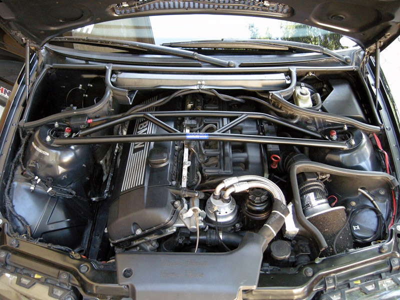

Lot's of folks in the BMW world swear by strut braces, and on a McStrut car like we have and the BMW's, it makes some sense.
However, it looks like Porsche already saw this need, and my 986S already has a brace from each front strut tower going back to the bulkhead.
Still, if I found one like this one on my M3, I might add it on:
