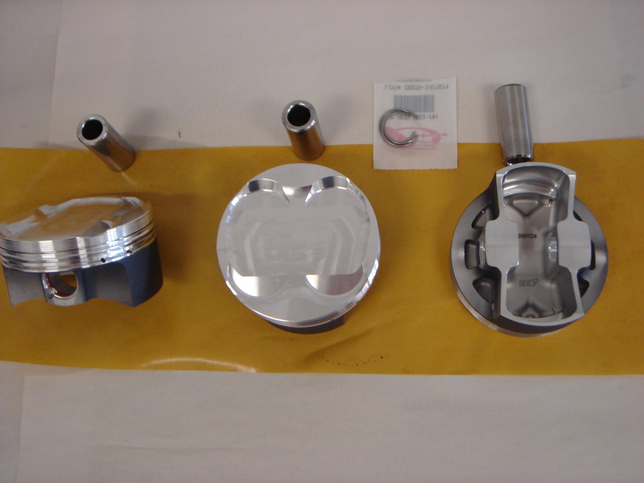

JE Pistons & short pins ready for install

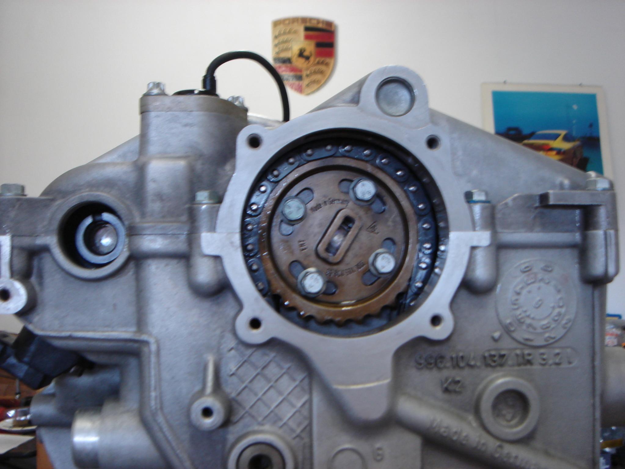

Cam Timing set :

Cam Timing set:
