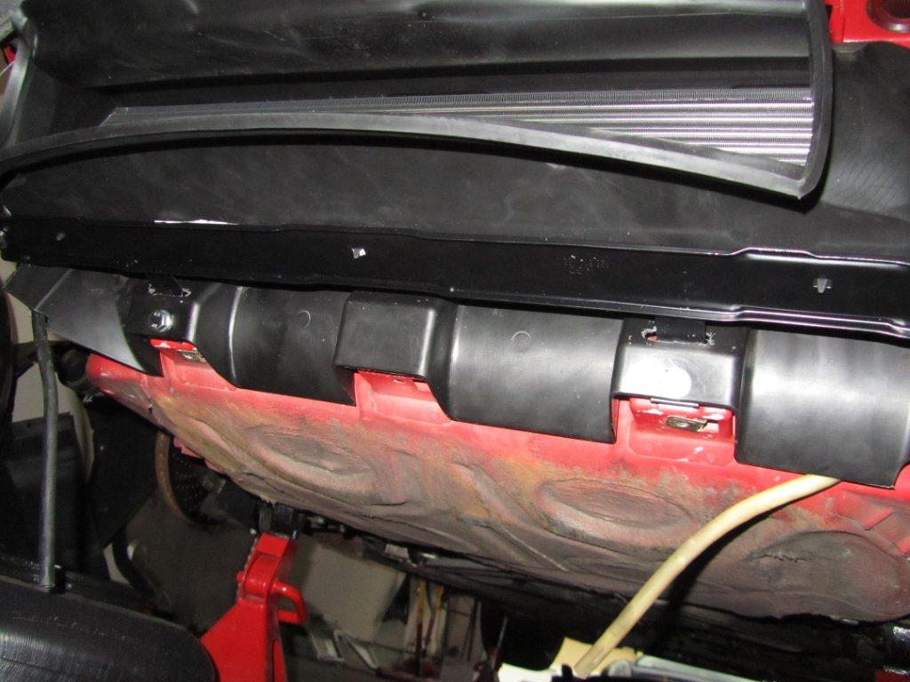

I just changed out some parts on the car, and thought I'd share a pic of the visual difference between the thermostat that came with the car vs the LN Eng low temp that I replaced it with.
See attached pic.
Interesting that the new LN unit required a push to get it on past the spring.

Do you see the car running cooler in the hot weather with the new stat? I've been trying to think through how the new stat combines with the stock fan temp settings. Seems like it would be cooler in steady speed driving but make no difference in traffic but I'd like to hear from somebody who's actually done it.
07-10-2011, 11:42 AM
#5
Posts: 6,693
We have quite a few in service, they all seem to behave the same way. The car runs at a lower steady state coolant temp, but when stuck in traffic, the fans kick in just as they normally would, but when back moving again, the car returns to the lower steady state temp.
A couple of observations to prevent confusion: The dash gauge does read slightly lower, but you need to remember that these dash gauges are both woefully inaccurate and non linear; so you cannot put a lot of faith in them at the best of times. But with the LN stat installed, they do display a lower steady state temp. Secondly, the so-called "A/C hack" to get the dash controls for the air conditioning to display coolant temps is not accurate. I have never seen one that displayed the same values as a PIWIS, Durametric system, or even a lowly OBD II scanner. Differences of 20 degrees or more are not uncommon, so I would not trust the A/C display value at all.

According to the (questionable) gauge, it does run slightly cooler.

I use these units in every engine that we update or create from scratch, it's not even an option...
When teting this for LN several years ago the differences were huge when using REAL data acquisition with stand alone analog sensors.

Yes, I would concur with JFP in PA, the only other thing I would add is that with the a/c on, the water temp stays in the low state longer, even in a traffic jam.... esp now that both my fans work.
Definitely a recommended mod. But it doesn't increase the ultimate cooling capacity (as espected). Just keeps the engine running cooler longer.

we discussed this a bit on another post, but something that strikes me as weird / dangerous about this motor's design is that the thermostat is on the INTAKE side of the engine.
this means that when it opens, cool water from the radiators will flow past & it will start to close again. this is contrary to ALMSOST every other motor i've seen. so, our 190deg thermostat is actually trying to maintain the cool radiator water at 190, NOT the hot side. this strikes me as a) pretty hot and b) pretty dangerous.
that having been said, this realization has made me a firm believer that the low temp thermo is the correct way to go.
