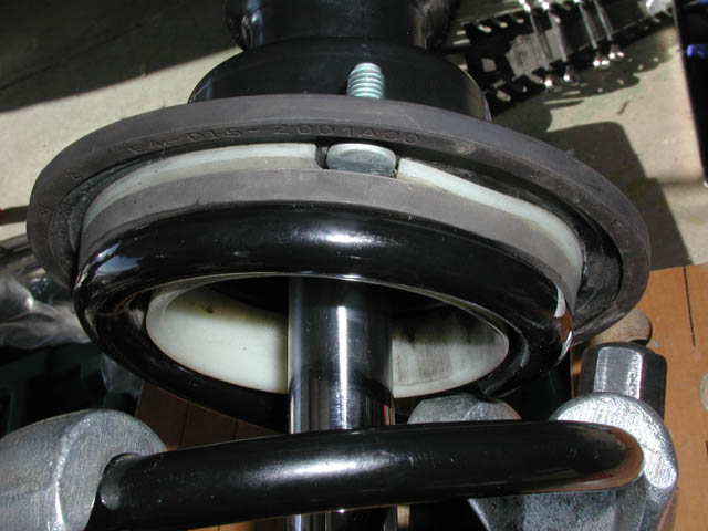

Also make sure the the studs for the three strut mounts are aligned properly and resting in the plastic "cup" correctly. Like this:

I did double check to see if they were fitting in the cup and they were. Also, i noticed in the pic you provided that the struts have the rubber ring on the top. I had the ring on my rears, but not on the fronts.

Its not my picture, I stole it from someones site. For a parts diagram blow-up, check www.********************************************.com
