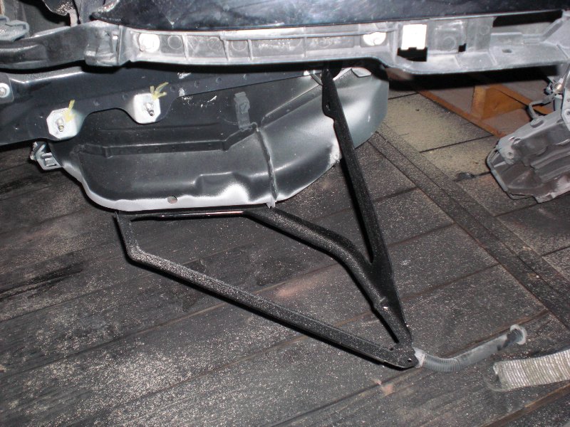

I told a BoxS owner last night:
"we removed every other bolt holding the front fenders on"
That is how serious we where about getting weight out of the customer car
This is the radiator mount for the drivers side.. we trimmed it down.

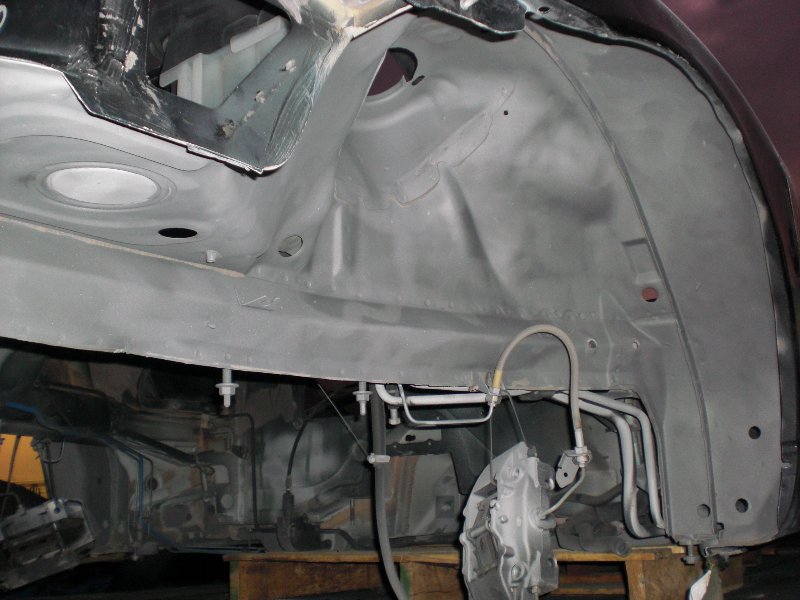

This is after blasting. This is the right rear inner fenderwell. We removed over 40lbs of sound deadening and undercoating.
