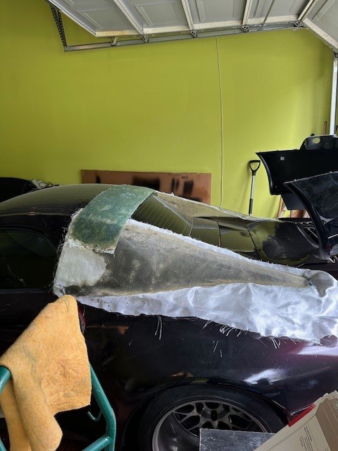

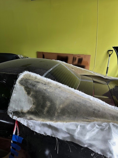

Bringing this idea back. Made a bit of progress but curious about the top. Would like opinions if you think it is better to mold the side pieces directly to the hardtop or incorporate the top strip linking the side pieces together.

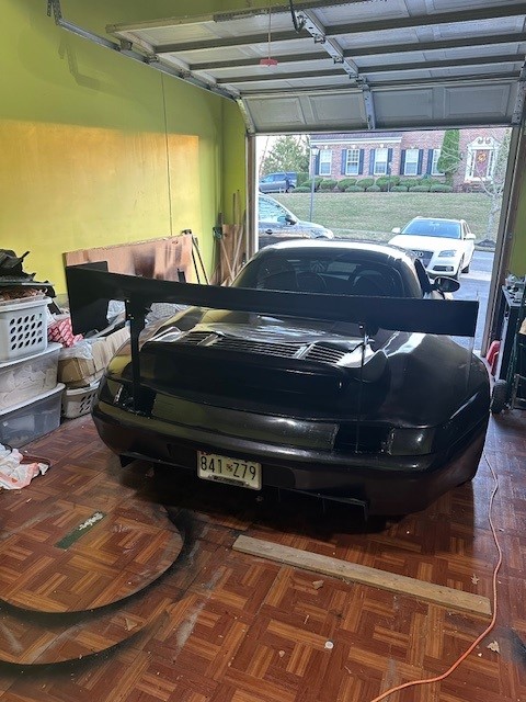

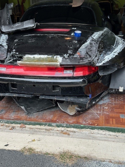

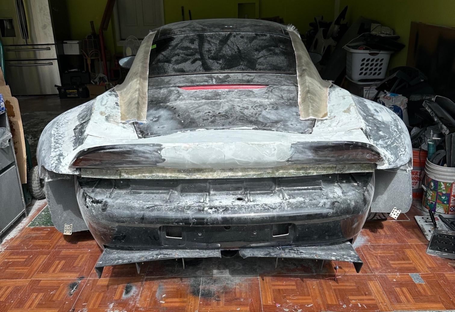

alright I decided to mold the side pieces to the top. Currently working on that and a redesign of the rear end. First pick is what it looked like, second pic is the inspiration and 3rd is current progress towards that.

The sunk in tail lights look good.
Nobody is gonna mistake your car from some other 986 thats for sure!!
