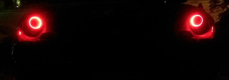

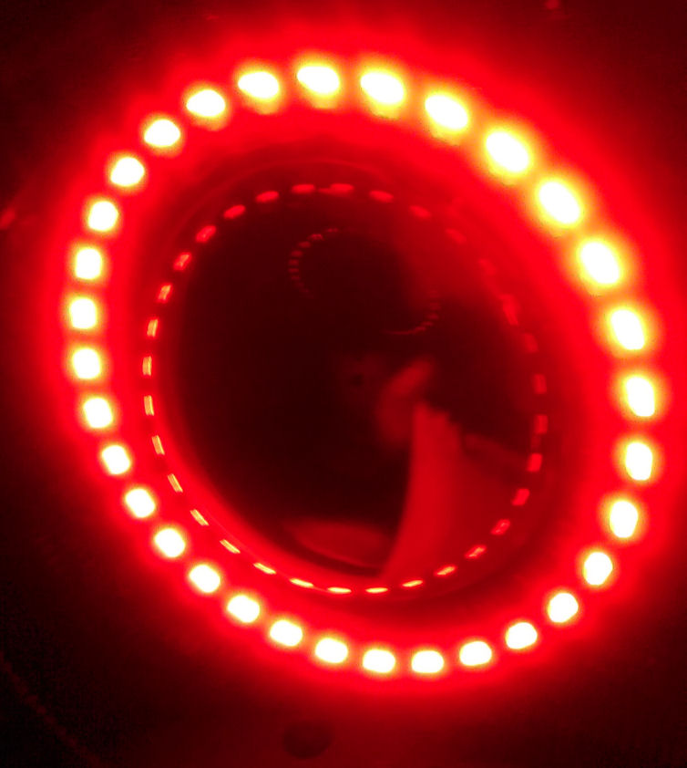

Happy Halloween! Thanks Fred! Thanks Charles!

Old 11-06-2014, 09:46 AM   #718
Nine8Six's Avatar
Posts: 3,249
Wicked stuff!!!
Use when young kids are in bed only. I can picture them calling on mommy if they see a Porsche car with evil eyes coming down their street
Thing's alive mouhahaha lol
Old 11-06-2014, 10:39 AM   #719
Pdwight's Avatar
Join Date: May 2013
Location: North Alabama
Posts: 2,079
Are the red halos legal in the US ?
Old 11-06-2014, 10:58 AM   #720
No, but who's counting?
They could be unplugged in the rear if it became a problem.
