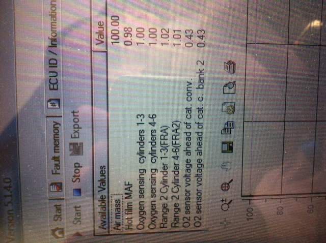

I played with my Durametric (enthusiest version) and it is indicating Motronic 5.2.2. I'll attach some interesting photos. I'm thinking I might have a bug in the Durametric application itself. BTW, I couldn't find the other parameters like MAF and RKAT. Sorry my photos are sideways (darn iphone).

Wow! If your Durametric software gives you bogus information about your fault codes it is surely goofed up or not very useful at best. Here is the description from Porsche.
Scroll down for relevant codes:
http://www.pelicanparts.com/techarticles/Boxster_Tech/19-FUEL-02_Sensor/OBD-II-scan.pdf
