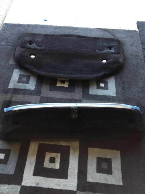

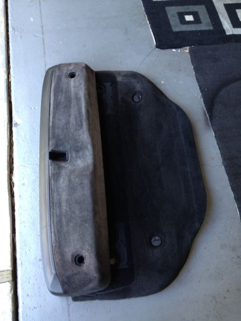

Thought I share some pic's of my faded engine cover carpet.
I have black engine cover carpet that was faded from the sun.
It had turned silver from the exposure. Brushing the carpet with you hand would produce fine silver carpet dust particles..
Vacuumed it well before painting.
I used Dupli-Color Vinyl & Fabric paint to fix my faded carpet. (AutoZone)
See pic's
T
Before
Size:  41.9 KBName:  IMG_0516.jpg
After
Size:  40.9 KBName:  IMG_0519.jpg

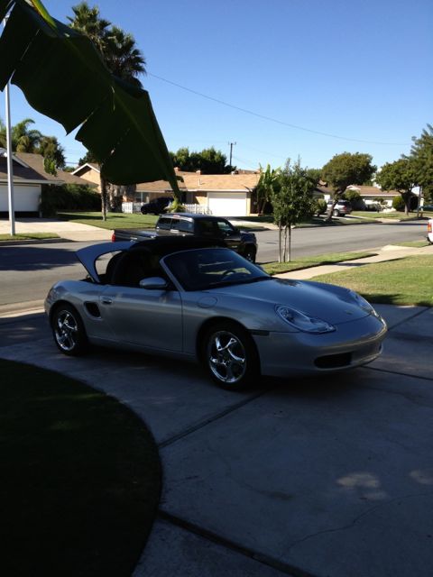

Service Position..

Yes the carpet is stiffer after the paint dried, I did the same as Bala.
My goal was just to get it back to Black.. That faded silver did match the car color somewhat, but looked bad..
I'm happy with the results..
