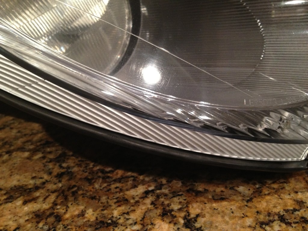

Here's the finished lens!

Not bad! I've heard of some users on the forums that put a protective film on their headlights after refinishing them, by 3m I think. Would hate to see your work go to waste by a rock chip! +1

Hmm, I'll look into that film, prob not a bad idea since most my driving is freeway, and the other headlight is brand spanking new.

Check out SEM Solaray UV headlight coating. I think there is even a youtube video doing it on a Porsche 997. Your headlight will yellow if you don't replace the coating you just sanded off.
