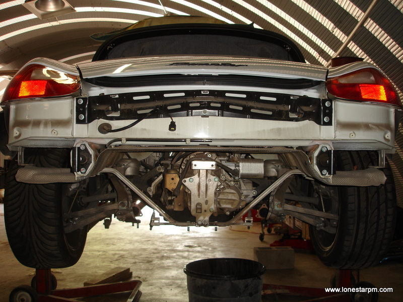

i don't have a jack, but i crawled up under where i could. i see the protection plastic guards. but where would i find the heat shields? any pictures out there?
basically behind the bumper and above around the exhaust and tranny.
Hope this picture helps.
Mike

wow. awesome pic. thanks. unfortunately, mine is not the heat shield. i found it and played with it. solid. no rattle. it also is not the belt. opened up the engine compartment and did not hear the rattle with the engine on and belt turning. frustrating. i think it's coming from the exhaust system, but just can't localize it specifically. when i tap on the exhaust pipes or cats, i can hear it. but just can't find it!!! arrgghh!!
