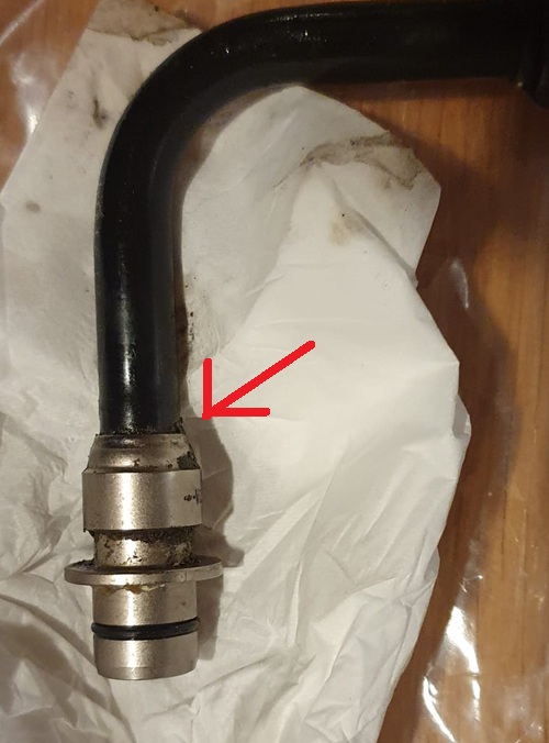

It is indeed the 90deg bended pipe, but the pipe itself turns in the adapter (not the adapter in the steering rack, which would be ok). So it turns at the red arrow:
Would I have read about this connector is that inside that part it also has an o-ring (or two?) sealing the pipe. Then this adapter is 'crimped' onto the pipe. It seems like this crimping is not effective anymore.
Uhh, that's no good (This means you will need a new hose..) :-(
A while ago (on my 987CS) I installed an external cooling radiator for the power steering, using the the high pressure connectors that plugs into the rack, cut the metal pipes off and took them to a machine shop to weld an AN fittings to them (where your red arrow is), then used standard AN fittings to plug the lines into the hoses that runs towards the rear of the car. Hopefully my explanation makes sense.

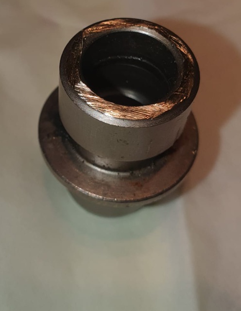

So I cut two pressure connectors off as well. One had the valve gone bad, so I removed it. Seems it was pressed it.
Do you happen to know the alloy these are made of? It is not ferrous (not sticking to my magnets), it is not aluminum. Looks a bit like brass? (but then zinc plated?)
Just wondering for any welding...Should get some similar metal for the other side, no?

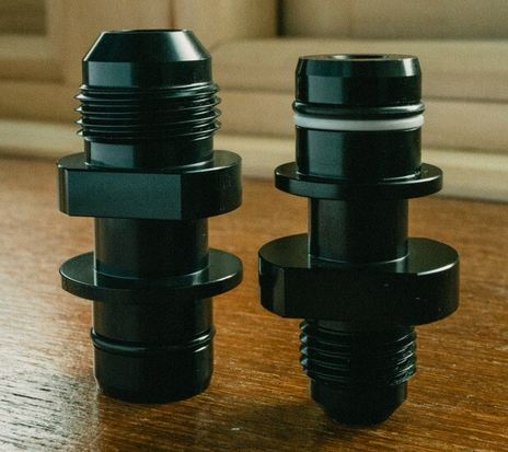

As for fittings there are three types available in Europe (all in the UK unfortunately);
Aluminum ones, using the Porsche style O-rings. Look fine quality wise

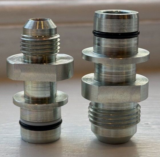

Same shape, but zinc coated steel. The finish does look a bit rough (lathe rings at the 37deg sealing section)

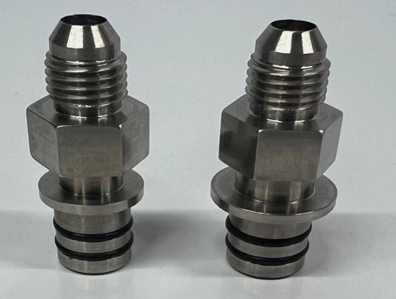

Or stainless steel ones using a different double O-ring sealing. Finish looks good.
The adapter at the hose end is going to be either steel or stainless steel.
Any recommendations? I am leaning towards the stainless ones.., but open for input
[Edit]
Looking in more detail, the stainless steel ones have both lines going to AN6. The JIC fittings I can get allow up to 3/8" hose. Porsche actually uses 1/2" and in many places it is suggested that the return line should be oversized compared to pressure line (low pressure drop on the return). So leaning to either steel or aluminum ones now.

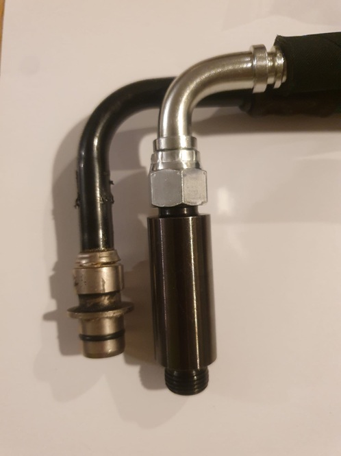

Still, the price of the adapters I can find just doesn't feel right. I know in the cost of the whole project I won't see it in the end, but still USD 190 for two of those small things? That is just insane.
So, not wanting to support insanity, another idea came up. There are hydraulic bulkhead adapters available which can be welded in. These have a thick middle section which can easily be shaped on a lathe to fit the steering rack. This part is less than USD10, so easier on the wallet. I am now searching for someone with a lathe.
Here you can see the black steel bulkhead adapter which can be turned down. Attached a 90 deg hose fitting. As you can see, comparing to the original, it would come out at about the same place.
