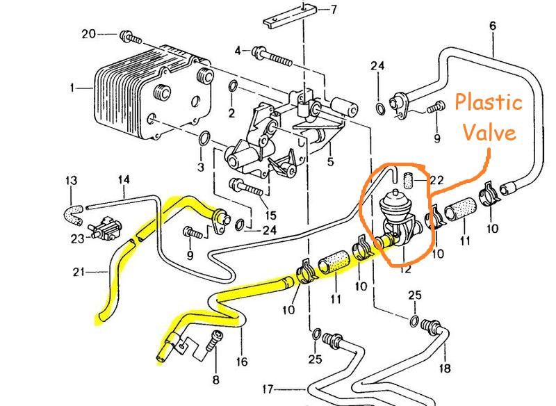

It the car 'Tiptronic' or manual transmission? There's a cooling line going back to the transmission cooler on the Tiptronics. The valve for the transmission cooler is under the trunk and is the weak point in that loop.

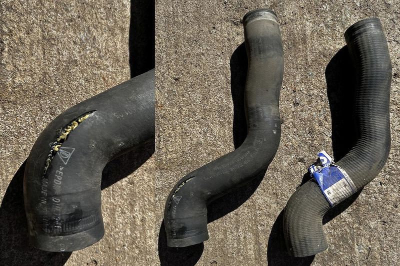

Check the hoses, especially the ones that connect at the front of the engine. I recently replaced one that had a 2" long split in it. Another hose that had weakened and bulged and was likely to give out soon. * Those would not lead to coolant in the trunk.
