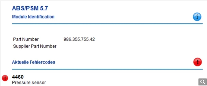

According to Durametric, the following error message is displayed:
Fault code 4460 - Pressure sensor
