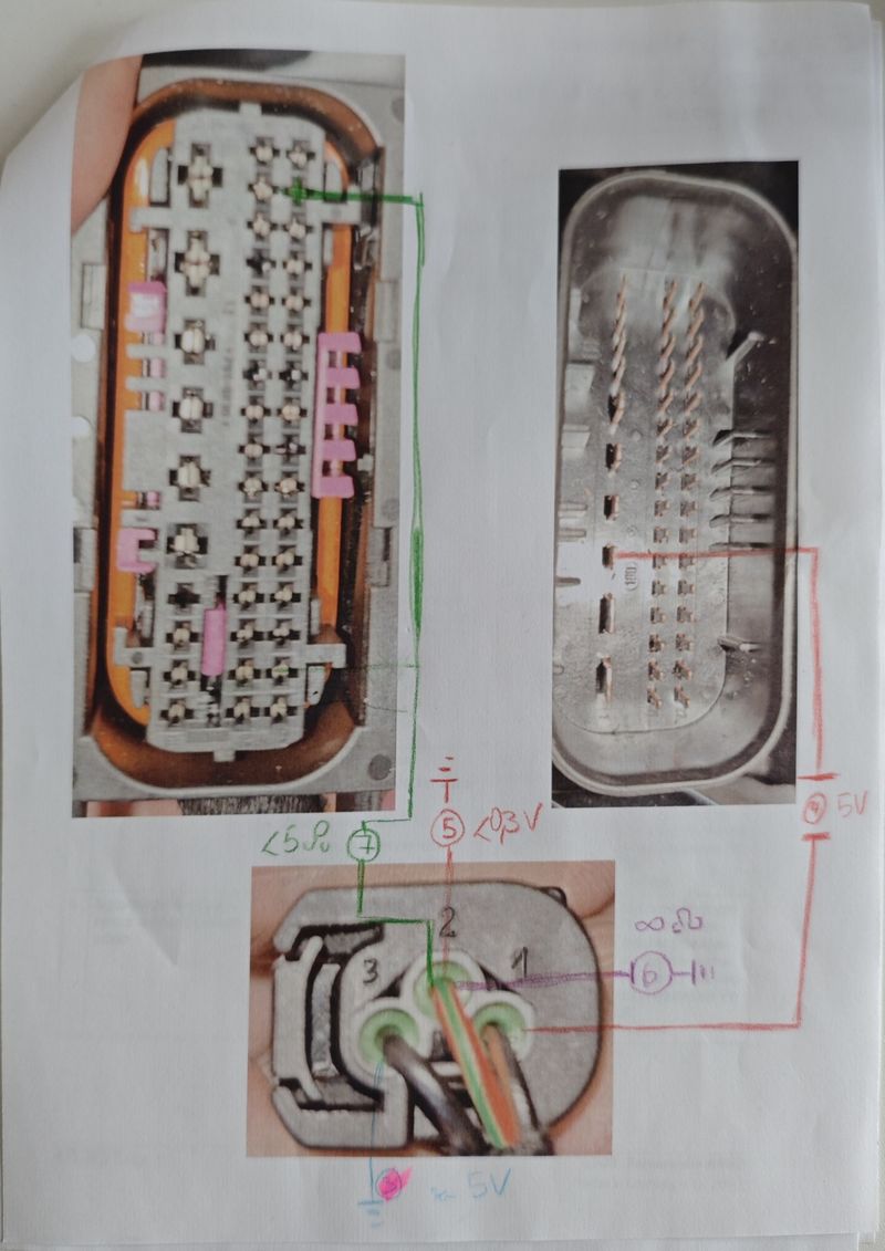

I performed the following measurements:
1.) Plug connection on the brake pressure sensor is clean and free of corrosion
2.) Check supply voltage of the pressure sensor for short circuit to groound/ open circuit: approx. 5 V ---> 4,98V
3.) Check ground of pressure sensor for open circuit: approx. 5 V ---> 4,99V
4.) Check signal lead of the pressure sensor for short circuit to voltage: < 0.3 V ---> 0 V
5.) Check signal lead of the pressure sensor for short circuit to Ground: < 5 Ω ---> ∞ Ω (some Papers says here "∞ Ω" ??? https://www.pff.de/wcf/file-download/419292/)
6.) Check signal lead of the pressure sensor for open circuit: < 5 Ω ---> ∞ Ω
I carefully cut open the nylon hose from the ABS control unit connector and couldn't find any broken wires.
My questions:
Can someone tell me the correct value under point 5.)?
How can I resolve the apparent broken wire under point 6.)? Simply run another new wire in parallel?
