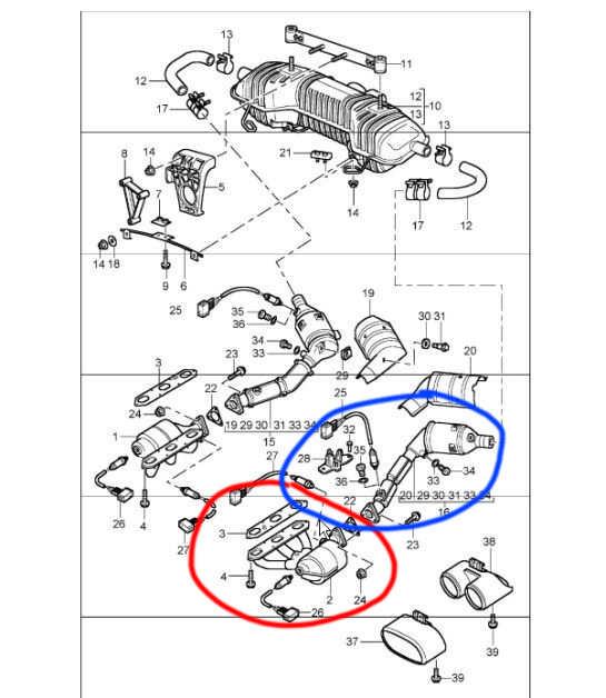

P0430 - Which Cat? 2003 S
P0430, associated with the bank 2 catalytic converter - the "three way" or "main" cat
Which one is that? The one that's part of the manifold assembly? Or the one after that? Which is the correct part to change associated with a P0430 on a 2003 S?
the one circled in red (99611310407)
or the one circled in blue (996-113-023-BX)

What kind of diagnostic tools do you have? Any that will display the wave form of the O2 sensors signals?
https://986forum.com/forums/boxster-general-discussions/77357-p0430-what-do-post626811.html#post626811 had the same problem and there is a discussion there on what he was checking including the wave forms he was seeing.
