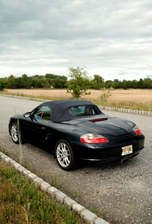

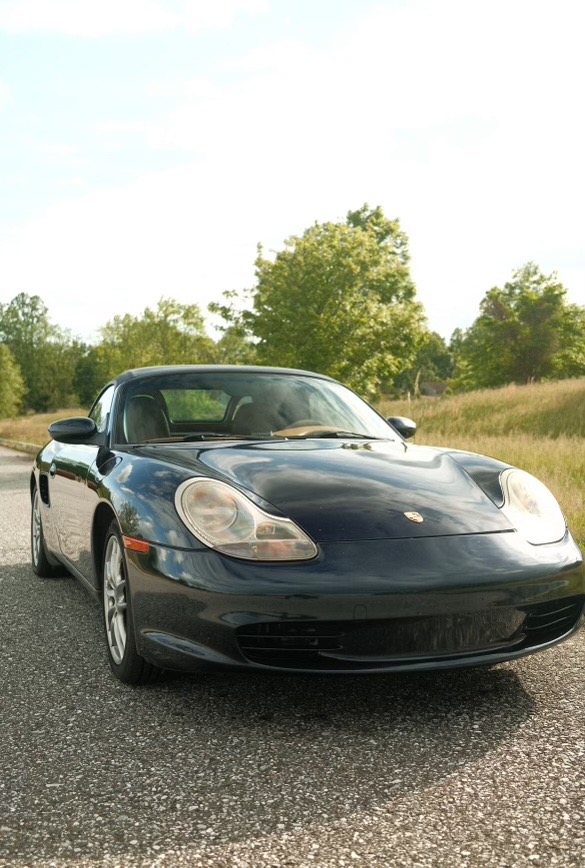

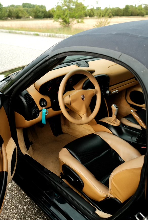

Here are some pictures if y'all wanted to see!
