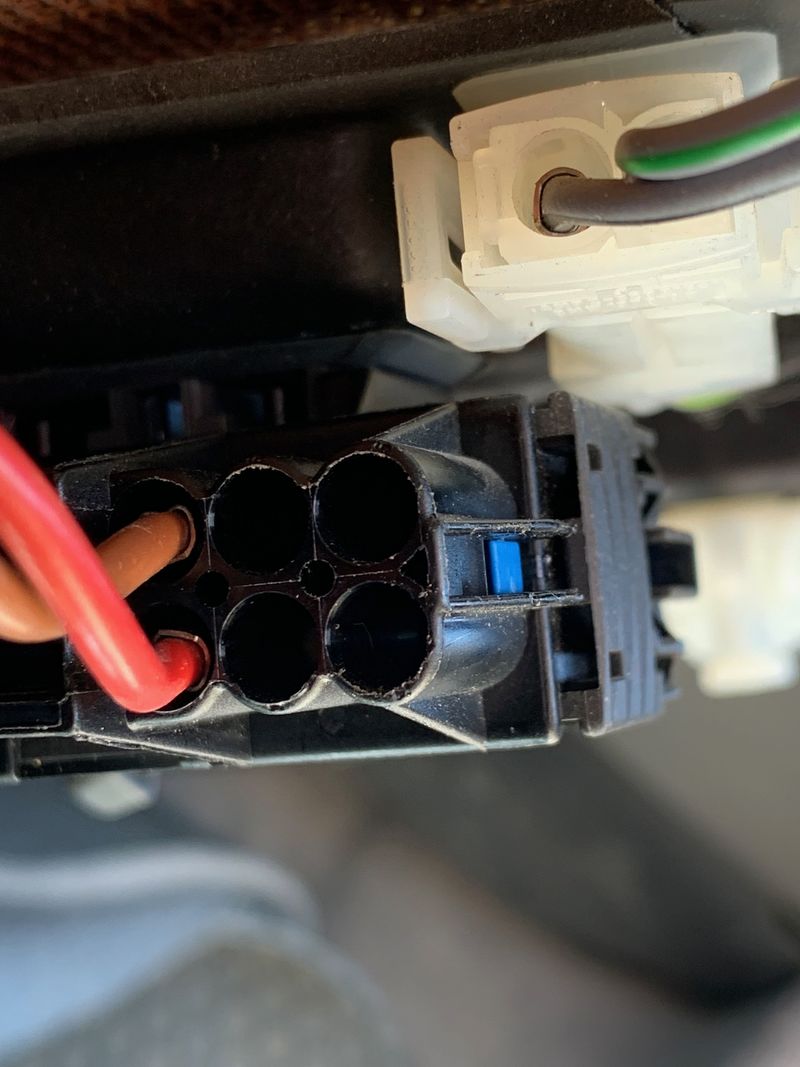

Hi everyone, I'm new to Porsche ownership. I have a 2002 986 Base Manual. I changed the water pump. I slid the passenger seat forward to gain access. I did not remove it. The air bag light came on when I restarted it. I have a Porsche specific code reader by Icarsoft. It wouldn't reset the air bag light. Took it to a dealer, they couldn't reset it, they tried 2 or 3 different processes or machines to attempt reset. I don't know if the air bag will still work with light on, but I want it to work. Maybe a connector came undone under the seat. I have the seat out, and there is one lose connector not attached to anything. My car does not have heated seats. The loose connector has 2 wires going to it, brown and brown/orange. There is an empty socket on plastic housing mounted to seat, but I'm not sure that's where it goes. is that for the addition of heated seats? Can anyone help me please, either how to turn off the light, or find out if something is unplugged by moving the seat forward.

Hi guys, Well I took my reader Icarsoft Porsche compatible back out this morning after watching some youtube videos. When I just read obd codes there are none. If I go into Diagnostics and manually choose AirBag system and then get codes it gives me a 0003 code and says below it power supply. Does that help to diagnose it. I live 3 hours from a dealer and 2 from a good indie shop. Do you know what the unconnected connector under seat is for? Brown and Brown/Red wire. I don't have a manual or wiring diagram. All i did was move the seat forward to gain access to change water pump. What a headache. Thanks, Jerry

I think that connector is for the airbag deactivation bar. It's only used when you fit a Porsche specific child seat. Your problem lies elsewhere.
