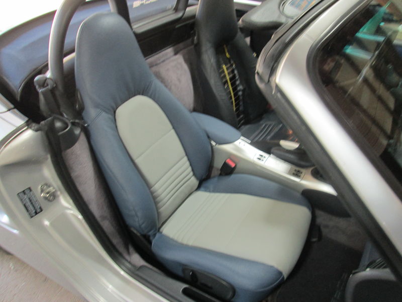

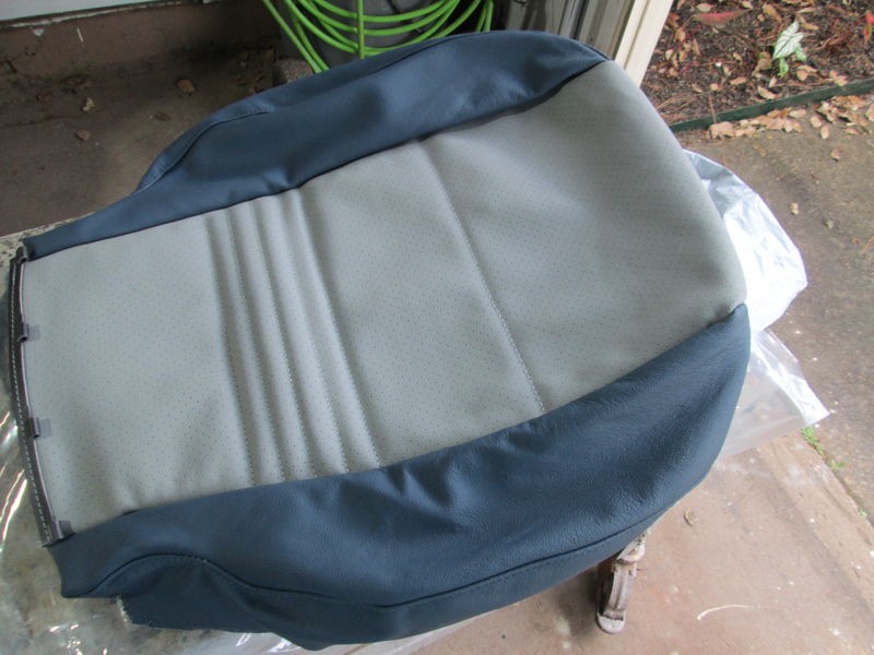

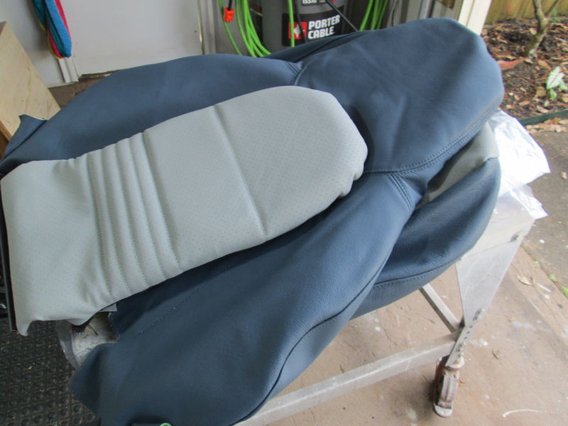

The old upholstery was cracked and tearing so it was time. I went with a dark navy with silver centers. They are very well made and should last years. I wish the blue was darker. I guess I could dye brand new covers. I will post updates. I have done this on a vette before and it is a job. My hands will be sore. Steam helps smooth things out.

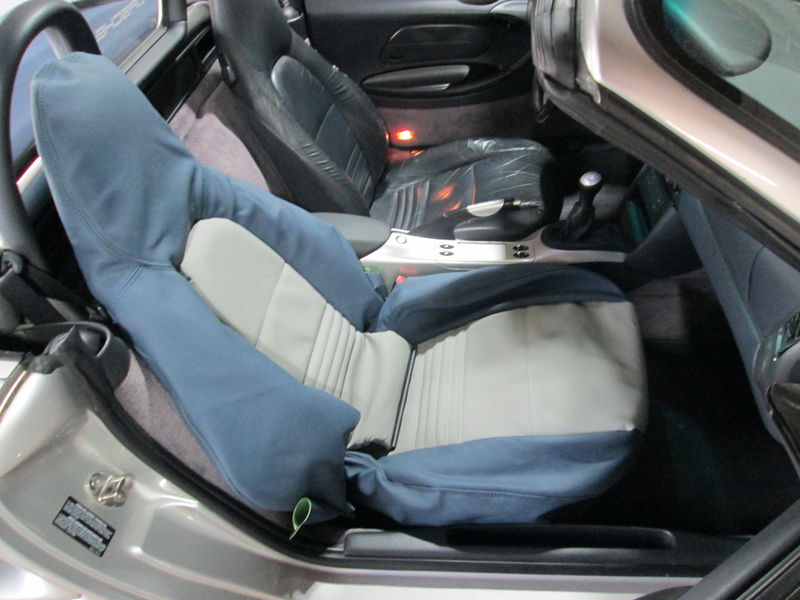

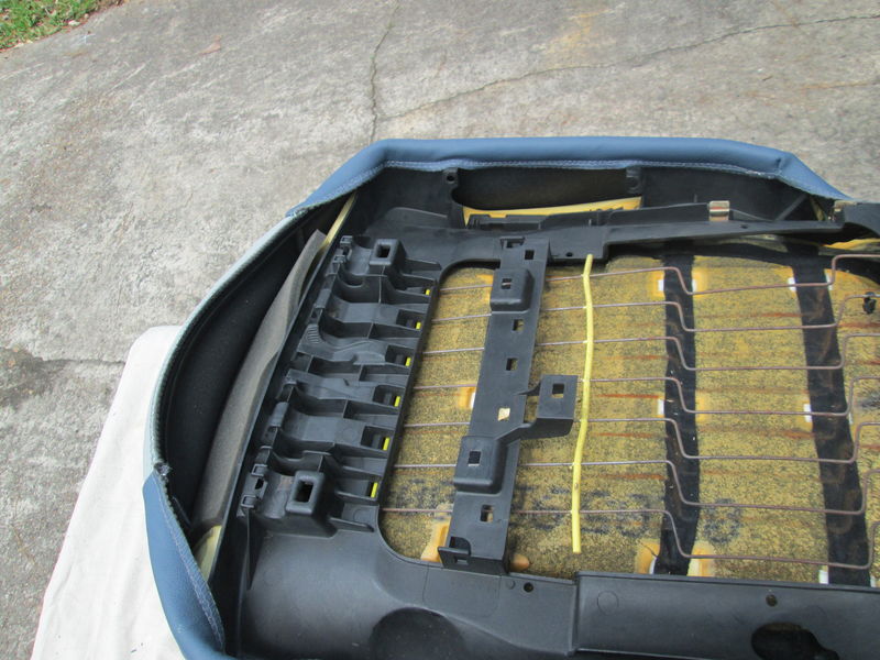

It all went well. There are built in hooks in the seat bottom. There are clips on the seat back and a channel for the back side. I rubber hammer helped that cooperate. Getting the front seat bottom was the hardest part for me. It was tight. It took four man hands. There are a few wrinkles but some direct sun should help. I had the nasty white stuff on the back plastic. Steam helped get that off as well as Simple Green. These are well worth the money and they feel great.
