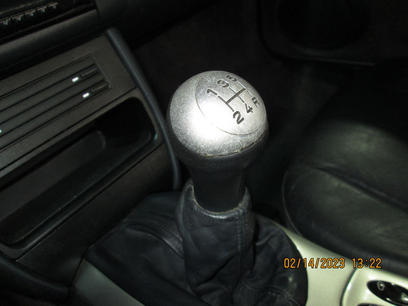

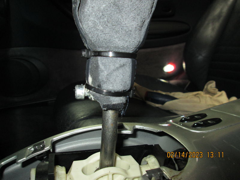

I am trying to learn about my recent 1999 Boxster. I was looking into the shifter today and considering a short shifter mod. Mine looks modded. .It has a set screw that is very hard to turn and the leather it snuggled onto the knob with zipties. It seems the knob will not just pull off. I am curious if has been cut down. It is a tad over 6" long from the top of the white piece to top of the knob. Not sure if the knob is original. How tall is a stock shifter?

I don't remember if mine had zip ties, but the shifter looks stock to me. I have the same shift knob as well.

Generally the knobs are friction fit. I may have smacked myself in the face removing it, I can’t recall.

Yup! Pull *really* hard. I think some early knobs may have a set screw as well.

That looks like a stock shifter. I just installed a short in my ‘04 S & it’s completely worth it. Most short shifters I’ve seen have an aluminum body & my stock one had the same plastic body as yours does. I did have to take a dremel to the black plastic frame or mount in order to access reverse.
The difference is night & day. The distance your hand travels is about half what it was & for me at least gears are more defined (especially 3rd)

That is a stock shifter. It is also a stock shift knob and boot. I've had the exact same set up in 2 different Boxsters. You will need to loosen the Allen bolt to remove the knob and boot. The more basic knob and boots don't have the bolt and can be just pulled off (with a lot of force). The boot and knob will fit on any short shift that you would purchase.

That's really interesting. When I swapped out my shifter, I thought it was interesting that the post was blade/oval shaped and not a round shaft like every other shifter on the planet. I wonder why porsche went back and revised the part?
