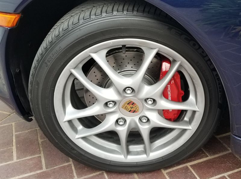

I had the calipers repainted, he re-did the lettering and then clear coated everything. I found new emblems for the wheels on ebay.
