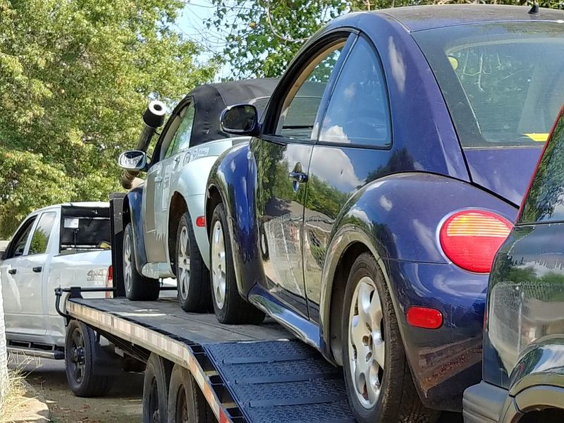

I had a VW new Beetle 1.8T convertible that the AISIN automatic transmission failed on (due to my abuse, not fault of the car). I spent a few months trying to fix it. After flushes and replacing a solenoid, it improved, but would still slip. I decided to sell it with a bad transmission and after a couple weeks had only one buyer interested. It sold for $300 in driveable condition along with a parts car to do a manual swap. I would have Given it away at that point, but it can be more hassle to get someone to take stuff for free than to sell it cheap.
