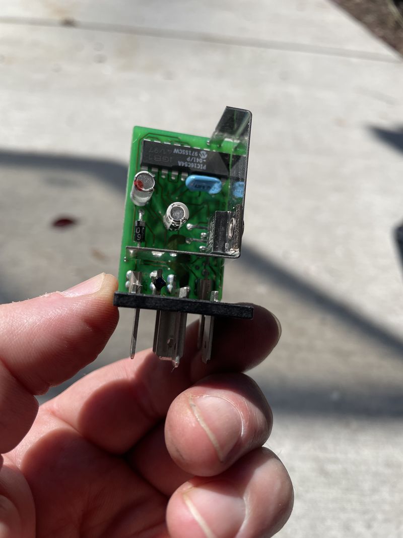

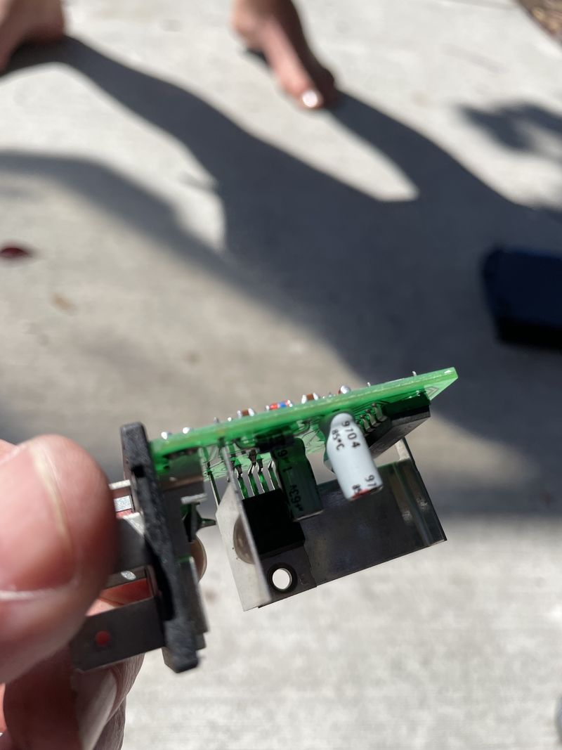

Switching relays seemed like a lot of work so I simply removed the relay, cleaned up the contacts and pins on the board, reassembled and put it back. For those that are looking to remove this relay, it is held in with a plastic rivet that you have to push the center pin through the rivet to remove. I took the car out for a brief drive and the seat heater was behaving itself - but time will tell. I was expecting a mechanical relay when I opened it up and was surprised to find the following...

That makes a great deal of sense. Was wondering how they did it. Also makes sense now given the price of the relays.
if it happens again, find an old school circuit board repair guy in your area. I bet one of the surface mount capacitors/diodes is bad and needing to be replaced. Should be quick work for someone.
