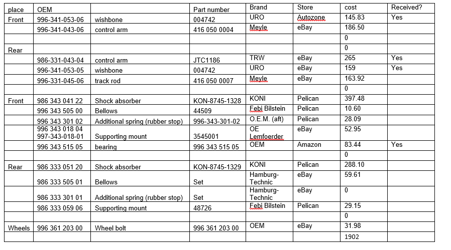

Suspension (all 4 corners, all new parts - some OEM, Meyle, TRW, URO, and KONI) less than 2000 USD,.

Thank You, I may take advantage of the 20% off the Koni shocks, we'll see.
I bought control arms from ********************************AZ and they're just under $100 there, plus they had great prices on the other suspension items I bought.
https://www.********************************************** **************/pn/4160500000
Jasper7821 is offline   Reply With Quote

You cannot use certain names here... otherwise you will become an asterisk or a star
for example, automotive store with rock name in it, shall be called stone auto?
not sure about auto and zone
you get the idea, right?
To get free shipping, you need to order each strut separately, otherwise they drop you $50 shipping charge.
Pelican seems to have the lowest price. I saw a set in my local store (via eBay), but they never responded... so forget them.
From what I hear - URO, Meyle, are OK brands for more important parts. Bellows or strut bumps - HT is fine...
