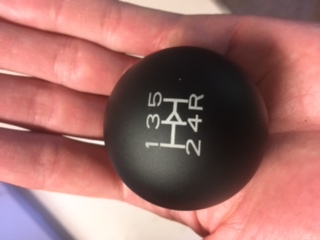

I just dropped off my completely beat up shift boot with the new base to an upholstery shop, so I don't have a pic of it in the car. Here is one of the etched aluminum knob. I thought I would like the delrin one I ordered with it better, but after driving with them both I enjoy this one more. Etching comes out better on Al too. Nice to have the option to swap back and forth though.

Good looking knob! Thanks for sharing.
