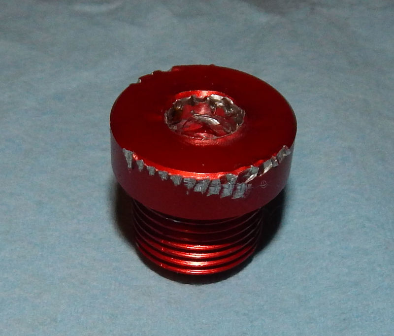

UPDATE - Need some advice - Oil drain plug damaged
Thanks for all the suggestions. Fortunately the first thing I tried happened to work. I jacked the car up again and sprayed some PB on it and let it sit for awhile. I happened to have a new pair of vise grips with some good teeth on them. Clamped it on the edge as best I could and it finally broke loose. I couldn't believe how much strength it took.
Anyhow I got it off ok. Oil and filter changed! Installed the original drain plug.
Yesterday where I started to tackle this I was kind of tired from already changing out the spark plugs and tubes. So, I think a fresh start this morning helped.
Here's what the plug looks like.
What material is that? Aluminum? I can't imagine you would have been able to do that to a steel plug. Aluminum on the other hand is not a material that I would consider using this application.
Sent from my POCOPHONE F1 using Tapatalk
Very bad idea. Every customer that tried using steel plugs instead of aluminum eventually ended up replacing their sump cover due to the damage the steel plugs caused. Use aluminum, the plugs are cheaper and easier to replace than the sump covers.............
Interesting, why is that? Over torquing?
